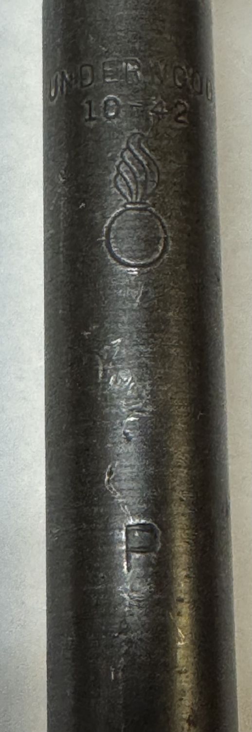

I searched through the SN spreadsheet and cannot find this early of a barrel. I've scoured the net and cannot find any info on barrel production dates by month/year.
Is this a rare barrel?

It is early, not the earliest!
Is it attached to a receiver?

It is attached to an Underwood from 3/44.
When did Underwood start producing barrels? They didn't start producing guns until 12/42 right?

Post Options Post Options   Thanks (0) Thanks(0)   Quote krag96 Quote  Post ReplyReply Direct Link To This Post Posted: May 18 2025 at 3:29pm
My Underwood Carbine  sr #1,350,069 also has a 10/42 barrel and was in the first delivery to the Gov't from Underwood, 12/42, (as far as I know).  ''War Baby'' is a good reference, you can spend a lot of time with that book.
My Underwood is a well worn Korean buy-back from the 1990's and so marked. Who knows how many times it was rebuilt.

Congratulations on having one of the earliest Underwood carbines, However your receiver was made by Inland!
The club published documentation from Underwood back in May 1998, Newsletter 259 page 3
Underwood replying to a directive listed 200 receivers that Inland sent to Underwood to assist in the start of production. It gave the original Inland serial number and the Underwood serial numbers place on them from 1350101 to 1350200.
They then state they received an additional 110 receivers from Inland that were not marked with serial numbers. 91 pieces were marked wit the serial numbers 1350010 to 1350100
So you carbine was assembled after the first 200, which probably accounts for the barrel date. That also would put into the second month of deliveries, Dec 1942. Nov 1942 only 100 were delivered.
Please post some pictures of the receiver, Left, right, bottom, Name/serial as well as front ring markings.
So as cool as it is to have a 9-42 Underwood barrel, the OP would need to find a receiver that was very early.

Post Options Post Options   Thanks (0) Thanks(0)   Quote krag96 Quote  Post ReplyReply Direct Link To This Post Posted: May 18 2025 at 8:51pm
Not much here, just a few photos of the receiver and barrel.
