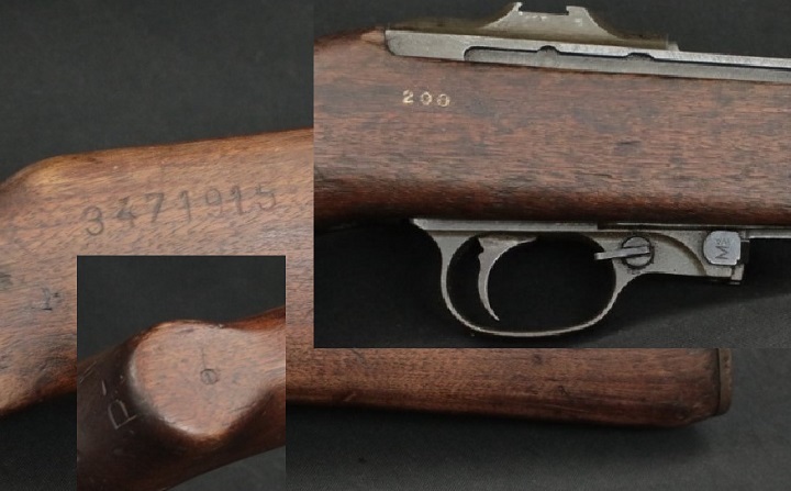

Post Options Post Options   Thanks (0) Thanks(0)   Quote New2brass Quote  Post ReplyReply Direct Link To This Post Posted: Jul 26 2021 at 8:34am
We have listed 50, 100, and 250
Here is a 200
Post Options Post Options   Thanks (0) Thanks(0)   Quote Smokpole Quote  Post ReplyReply Direct Link To This Post Posted: Jul 26 2021 at 9:59am
Just scratching my head and wondering....Since so many of these carbines were rebuilt and the sights were changed: is it possible that those markings could be the range at which the 100 yard sight setting would be dead on?  Crazy idea, but if you think about it, it could be a possibility.
Post Options Post Options   Thanks (0) Thanks(0)   Quote Matt_X Quote  Post ReplyReply Direct Link To This Post Posted: Jul 26 2021 at 12:13pm
Dan speculated about that earlier.   It could make sense if they all were resighted to 50 meters.  But now it seems less likely to me the stocks would be stamped to alert the users of the range it was sighted to.   I think the evidence now points more toward some sort of logistics or tracking need.
I could be completely wrong but think its worth looking in this direction too.
I suggest this because of the following:
* So far the IMI surplus police ammo seems to shoot with about the same trajectory at 100 yards as the Korean surplus.
* The known stamps are 50, 100, 200, 250.  That seems like an awful lot of discrepancy to ask the person issued the carbine to remember when push comes to shove.  For example at 100 yards there's about what? an 8 to 12" difference in a POI when using the tall flip sight instead of the short one.
* Locations vary and some stamps are inked others, at least some 50s are not.    For field use, consistancy of location and ease of reading ought to be a high priority.
