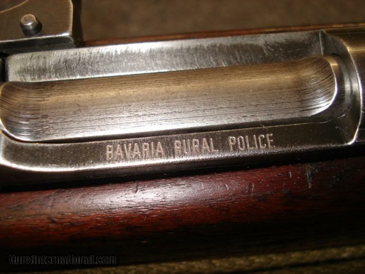

Post Options Post Options   Thanks (0) Thanks(0)   Quote sleeplessnashadow Quote  Post ReplyReply Direct Link To This Post Posted: Oct 19 2022 at 7:20am
Chief,
Your carbine was listed and sold on Guns International in July 2014. Two of the listing pics are included below along with a datasheet they posted in the listing. I've kept pics I gathered while doing the research.
At that time the trigger housing was LGKST 5124. Someone has since attempted to remove the T. It had the markings of the Bavaria Rural Police on top of the left side of the receiver. Your receiver pics caught my eye as the receiver appeared to have been altered in that area.
All of the LGKST (Landes Gendarmerie Steirmark) carbines were among the Austrian returns CMP received from the Army. There were two shipments. The first in late 2008, the second about 2013. I was at CMP for the first two weeks the Austrian returns were inspected by CMP armorers in February 2009.
All Irwin-Pedersen carbines were separated out and sent to the CMP auctions. Not sold for a fixed price. Normally CMP armorers didn't swap parts between carbines to make them "correct". The exception were sometimes rare ones that went to auction.
Your stock was on your carbine when listed on Guns International. The 0498 and 3357 in the slingwell indicate the stock was not on the carbine when it was used by Austria or Bavaria. Otherwise it would have the last 4 digits 1130. CMP had one carbine with the 0498, 2980498. They also had one carbine with the 3357, 4563357. Neither was an IP. I do not have the s/n's of the ones that went to auction.
Because your carbine was used by the Bavaria Rural Police it should have the last 4 digits of the s/n on the rear of the trigger housing, top of the bolt, and on the outside of the slide arm.
The absence of the s/n on the parts indicated above, or the wrong numbers, indicates to me it was reconstructed into an "all correct" IP by CMP.
This may not be bad news, depending on what you want/like. But I think you should know. Many owners would have tried to reconstructed to all IP parts. Obviously someone removed the Bavaria markings and tried with the Austrian markings.
CMP keeps good records of the guns they sell. If you write them a letter and ask for the CMP certificate that came with the carbine, in the past they normaly have sent one out for free. I don't know what their current policy is but it would be worth having that certificate as it increases the value of your carbine.
Whoever did the datasheet either didn't look close or suffered from "old eyes" afflictions with the stock and maybe the handguard. It also indicates the front sight was marked IP. IP didn't make front sights. Their sights were made by Niedner and marked NIP or just N.
Da1Chief View Drop Down
Joined: Oct 16 2021
Location: Suffolk, VA
Points: 133
Post Options Post Options   Thanks (0) Thanks(0)   Quote Da1Chief Quote  Post ReplyReply Direct Link To This Post Posted: Oct 19 2022 at 7:32am
Ok, I will attempt to answer a lot of questions in this post.....
First to Dirty30Carbine....  Yes...  His Name is Curtis Ferrell from Indian River Collectibles.  He deals primarily in US Military rifles and pistols, nothing newer than M14s.
Next... Answering the BIG Question...
A member from the forum here contacted me by email with definitive proof concerning the history of my Irwin Petersen find....  Let me say this First and foremost, I am happy he did and thanked him.  I also gave them my full permission to chime in with any additional information or amplification they wished to, as they are MUCH more knowledgeable on the Bavaria Carbines that I.
Here is a brief synopsis of what was passed on to me.
1.  It is now a fact that my Irwin Petersen Was and Is a Bavarian Import. !
2.  I double checked the markings the Trigger Guard, Correct Markings are LGKST, 0124 (with double stamp on the 0) See Picture Below...
3.  The rifle was among the US Army Returns received by CMP back in Late 2008/2013.
4.  It would appear that it was in good enough condition that it was separated out by CMP in FEB 2009 or sometime in 2013.
5.  The Irwin Petersen rifles were separated out for CMP “Auction” at that time.  It would have been sent to the CMP Armorers and made parts correct at that time.
6.  The Stock on my IP is NOT the Original stock that was on it when used in Bavaria. (It is suspected the Armorers at CMP swapped it out to make it “Parts Correct”.
7.  The Current Stock was on the rifle when it went Guns International for auction.
8.  The Bavarian Marking on the Receiver were removed at some point after the auction. (See Pictures Below)
Conclusion:  It is what it is and glad to know the Truth and not have all the questions running through my head.  I am still Happy and Proud to Own It! (How could I not be!)

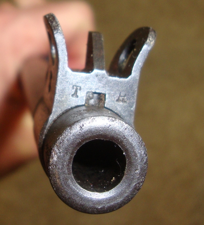

Post Options Post Options   Thanks (0) Thanks(0)   Quote New2brass Quote  Post ReplyReply Direct Link To This Post Posted: Oct 19 2022 at 8:27am
Look at the rear of the trigger housing for markings.
Front sight, look for markings on the muzzle end.
Being that the carbine originally has an RO barrel it may have had a TR or RP marked sight!
So was the barrel problematic and swapped out, the front sight re-used?
or
Rock-ola sent a small amount of barrels to Irwin Pedersen. The time frame is correct.
Did somebody read the wrong book and swap barrel to make it what they thought is correct?
Joined: Oct 16 2021
Points: 133
Post Options Post Options   Thanks (0) Thanks(0)   Quote Da1Chief Quote  Post ReplyReply Direct Link To This Post Posted: Oct 19 2022 at 9:18am
Just checked Trigger Housing and front of Front Sights.
Negative on any rear Trigger Housing marks
Front Sights do have T R on front
Thanks, I must have looked at front sights 30 times at least. Never thought of looking at the front nose of it for markings
