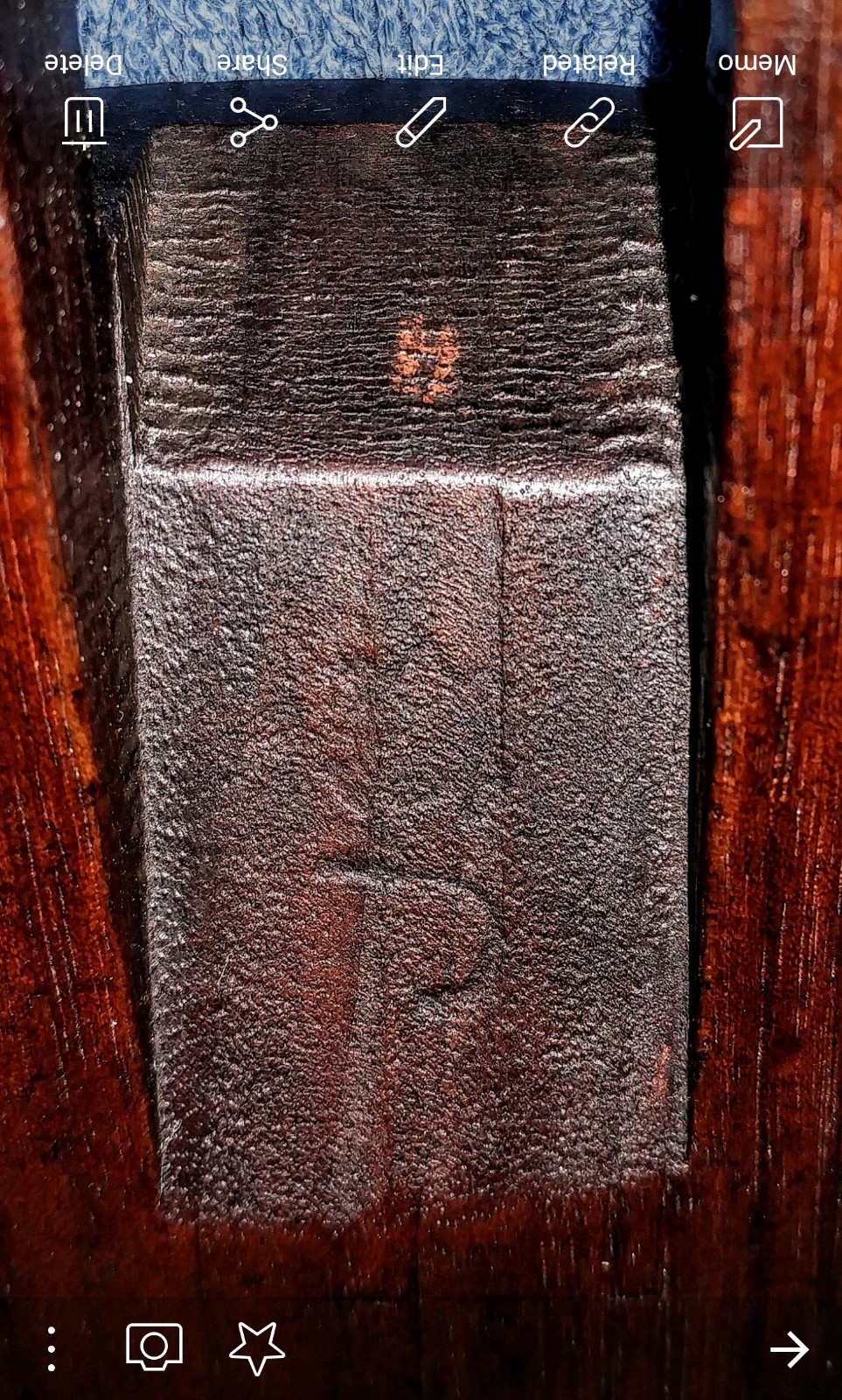

My S'G' has from what I understand is a wartime replacement stock on it, it is marked with a J in the sling well which I believe is for Jewell Bros. It has a very small CC Cartouche that measures 9/32 in diameter on the right side and has a saginaw serial # just above the oiler slot (not my carbine's serial#). Also marked MR on right side. My questions are. Was it common practice for replacement stocks to have a CC Cartouche?  And is the MR a Mount Rainier rebuild marking?

Jewel had a mini CC we call the hot dog CC as the bottom of canon looks like a hot dog.
For some reason that does not look as I remember. Is your measurement the canon or belt diameter?

This CC has a 3/32 belt. Most templates have errors. Amazingly exact copies of published CCs have shown up with those errors. As mentioned the one I have seen the bottom of the canon looks like a hot dog as it was curved.
I do not know if the jury is out on who actually made the J marked stock. As you see here it is listed as Jamestown Lounge.
There are JL-B stocks which we know as Jamestown.  There are P-J assumed to be Pederson Bros for Jewel. then the spares with large J
Jewel made metal parts and may have subcontracted the stocks as a spares contract. So who actually made them?
As to yours I really cannot make out the detail. Maybe pictures at different angles you could see more detail.
Given its size and consistent condition with rest of stock  I would venture that it is a correct CC found on those stocks

Thanks Dan, going to try to get better pictures of the cartouche, but it is very light and pretty hard to see.  I was going with Jewel vice Jamestown based on post I read on another forum by Bill Ricca, hopefully I can find that post again. Regardless of who made the stock my question about CC Cartouches on replacement stocks has been answered.

I would not say different, just not a good enough photo to go by. However lets look at in a different perspective (upside down)
Hmm, look at the trunion,  aon yours are we looking at the breech or muzzle at lower left?

I thought I was looking at the breech on the lower left. Maybe they are the same and I just can't make out the hotdog side. The darn thing is so faint it is hard to get better pictures.
Post Options Post Options   Thanks (0) Thanks(0)   Quote New2brass Quote  Post ReplyReply Direct Link To This Post Posted: Sep 10 2017 at 10:23pm
Number one mistake people make ius trying to take closeup. Put camera on high setting. Pull camera back so it can focus better. Then crop the picture. Playing with lighing also helps. Could try bringing light to level of stock to help shadows from the CC.
New pic at 2 O'clock i think i see a reminent of hotdog
