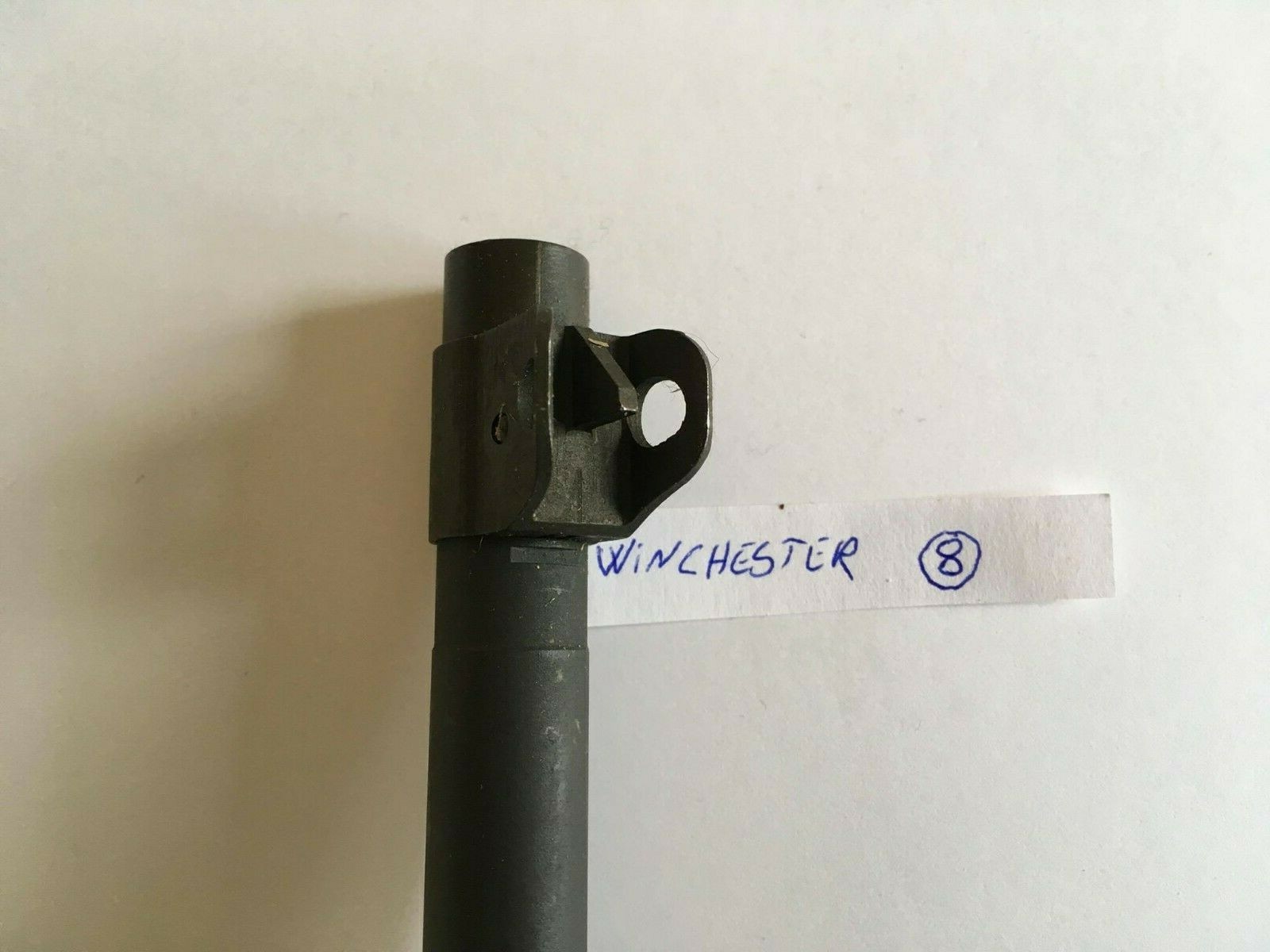

CCNL 356 has an article on type 3 barrel bands which are the ones with the bayonet lug.
It covers all reported markings.
The C Cowles bands have been reported with the high C which are the ones observed on late Winchester carbines. Cowles was a subcontractor to Winchester
the low C is reported as postwar
Then there is the serif C which is found on the opposite side of the band. It is not clear that this is, in fact, a Cowles band, however, the C. Cowles & Company logo uses all capital letters with larger serif C's
Does anyone have one of these? If so please let the club know
Monte Ferarri reported the high C and Low C packaged T3 assemblies which had the Cowles name and address and packing date of December 1953. Hmm does that mean the high C should also be considered postwar?
Then there is the small W which has been observed on packaged Winchester marked barrel assemblies.
It is believed that Winchester did not make these bands. From the drawing, it looks that it may be consistent with the shape of the Cowles bands. These are believed to be postwar.
If anyone has one of these I would be interested in it so I can compare to the others.
Looking at CCNL 371 there were some auctioned off Winchester carbines that came out of the Winchester factory that were not delivered to Ordnance circa 1975, Most notably the box of ten carbines.
6 were reported as round back C (high C) with 4 reported as Unknown.
 Then there was the "Perry Six". 3 were reported as having bands with the "W", 2 Unknown, and one with a "C". The C was not specified.
I have observed a carbine that is believed to have come out of the Winchester plant in the same time frame. The action appears unfired and in new condition. The band on it is a low C.

I noticed this NOS Complete WRA Barrel assembly auctioned 3-31-19.
Described as sent as part of Mutual defense in the 50's in Norway.
Bayoband has the W. Lower spot welds similar to locations found on C Bands and Unmarked Type II Bands.
Link to completed auction:
I believe I have a pictured stored that may have the W stamped lower...
Similar to the difference we see on the C marked locations.
I'll have to search for that later.
Hate to ask, But could you crop this picture ?
Regards
Charlie-Painter777
Post Options Post Options   Thanks (1) Thanks(1)   Quote tenOCEE Quote  Post ReplyReply Direct Link To This Post Posted: Apr 01 2019 at 12:03pm
If you look at that NOS barrel assembly you'll see it's an IBM tooled Winchester barrel. I've got the exact setup sitting across the room from me now, but I'm out of date for picture posting here. Mine is like that one in that it's an IBM tooled barrel with Win proofing and W type 3 bayonet lug barrel band. This one has a thumbnail front sight but doesn't really appear to be Winchester style. There is no W, only the WP. I can't remember if I got it from Todd440 or it came from a local purchase, but I removed it from the receiver it was on. Records were lost in a computer issue.
