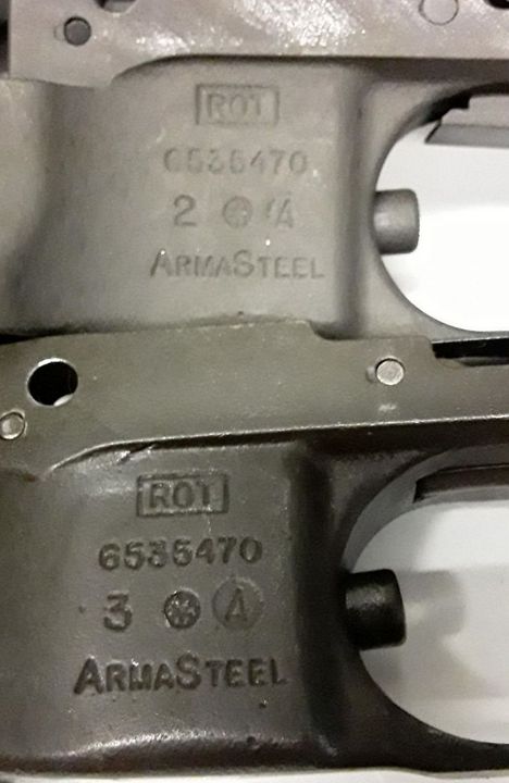

SMI (Saginaw Malleable Iron) was the supplier of M1A1 buttplate castings.
Their symbol looks like a wagon wheel.
8 spokes instead of 6, but 6 spoke wagon wheel seems consistent in their castings
The wagon wheel is not an indication of Armasteel, it is the foundry symbol of SGMI. SGMI had different formulas and Armasteel was one of them.
Red BAR trigger housing
Notice the 9 instead of the 3 in other picture. Hmm, sound familiar?
Post Options Post Options   Thanks (0) Thanks(0)   Quote m1a1fan Quote  Post ReplyReply Direct Link To This Post Posted: Apr 10 2018 at 8:58am
A wagon wheel, B-197491 and then a number. Great find! Fonts looks similar to those on a butt plate

Hmmm....The number before the wagon wheel is different, 2,3 and 9.
PMI=Pearlitic Malleable cast iron. ARMASTEEL was a registered trademark (#0393916) GM used starting October of 1937.
Here's a 4, 5, 6, 7 and 10:

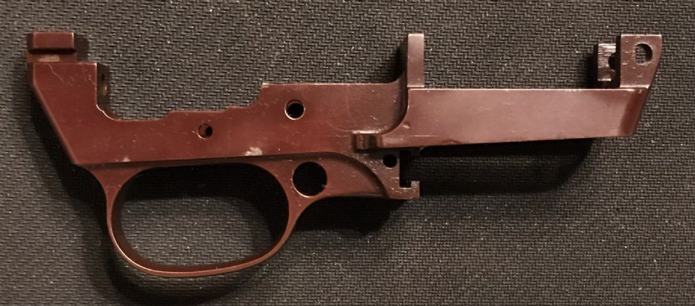

When this carbine showed up I had felt the trigger housing was possibly made or finished machining in 1959. I made comment about how the magazine wall was not consistent with  how Inland manufactured them.
Having a conversation with Gen. Hammer he pointed out that when I saw his Inland 270 that it was the first time I had seen that feature on Inland, but was done on other manufacturers. I had forgotten about the feature on XB 271.
Inland 270 to compare to pictures of XB 271 in this thread.
XB 271 is also absent the hammer spring recess.
What is different about the two trigger housings is the the side profile, where XB 271 is cut lower. This is reminiscent of the Winchester prototype.
Inland's early tool rooms were a shaped differently.
NewScotlander had already pointed out that the receiver, specifically the slide channel cut was consistent with pre-production receivers.
Combine the receiver and trigger housing and this was likely a pre-production carbine that either had a flaw or sat around one of the Inland shops till it was assembled with some of the later parts to be given to Mr. Lucid
