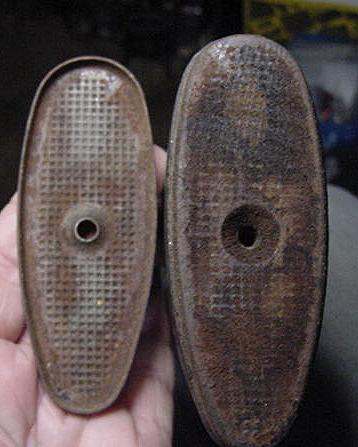

Did you find the Safety hard to push back and forth? It appears those are pry marks on the trigger housing and stock. Also seeing some heavier wear on the bottom edge of the front of the Mag catch that maybe proves there was some type of internal binding long ago. Pics show the pry marks on the metal have since patina'd with age. I'm wondering if possibly the Mag catch plunger broke or came part at one time jumping/binding between the Mag catch and safety, thus the prying ??
Would be interesting to know the length of the current Plunger if you get in to it.

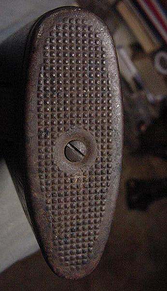

Butt plate: I have a few as rusty internally as yours is. I like to spray the inside with a Rust Convertor so the rust will stop. This will change the color. But it keeps me from having to keep removing it to maintain and I just maintain the outside as I get to it. I just don't like to keep stressing the thread holes.

Thank you for your expertise. The safety slides easily. I appreciate the value estimate also. The story I got was that a 95 year old WW2 veteran had it ever since WW2. That is all. I was wondering if the stock and trigger housing might have been in a jeep mount and got banged around? I need a type 2 slide stop pin and spring. This forum is the place to go for the best information. I thank everyone for all the responses.

Nice piece. I don't think the stock has been sanded. Looks totally un messed with. I would do a Kroil soak for a few days to clean it up. No steel wool just a toothbrush to clean off and stop any further corrosion.

Post Options Post Options   Thanks (0) Thanks(0)   Quote Matt_X Quote  Post ReplyReply Direct Link To This Post Posted: Jan 30 2026 at 1:39pm
What has been removed can not be put back.
The loose rust has already detached so it can not be put back.
What to do about the tightly bonded surface rust is different matter.  Charlie has offered a reasonable solution especially for a the inside hidden surface of sheet metal.
One thing that is really helpful in this instance is a very clear pattern transfer to endgrain.
On the outer surface I'm not sure what might be the best way to stabilize it.
For me that would probably depend in part on the storage environment and intended use.
It might also involve some testing on the hidden surfaces.

Kroil is a great product for neutralizing rust. It's a penetrating oil. I know the 1911 guys use it a lot. It's not cheap but it works great. I took a piece of PVC pipe and put a permanent cap on one end and a screw on cap on the other. Fill it with Kroil and you can soak a barreled receiver. Use a smaller container for the other parts. Soak for several days and periodically take it out and use a toothbrush to remove dirt and debris. Do not use steel wool or a brass brush you will put a polish on the parkerizing. After the soak use a good gun oil. Kroil is not a preservation oil.
Post Options Post Options   Thanks (0) Thanks(0)   Quote Matt_X Quote  Post ReplyReply Direct Link To This Post Posted: Jan 30 2026 at 3:20pm
I like that idea.
Kroil (Nano?) and Sili-Kroil are in my stock pile of rest penetrating and cleaning oils.  I've used it mostly on cars but also on machinery like rusted Jacob's chucks, and occassionally on dirty firearms.
It will help clean things up and then decide the next steps.  Best part is no permanent change.  Both parkerizing and 'blueing' are an oxide that helps trap a little layer of preserving oil.  Off the top of my head the only applied finish could be the top of the front sight, and the magazines. krpil would not lift either.
Post Options Post Options   Thanks (0) Thanks(0)   Quote painter777 Quote  Post ReplyReply Direct Link To This Post Posted: Jan 30 2026 at 4:39pm
I've used Kroil and Kerosene and seem to be equal results,
But I like Bronze Wool in 3/000 or 4/0000
After soaking and using the Wool wet with Solvent it's very important to wipe the slurry off often
with clean rags/patches as you go along to keep from scratching the finish surface. At that time I
also rinse or replace the Wool as I go. If you don't finish that day, lightly oil the metal down. Repeat
next day.....
Butt plates:
1 Some times just a high pressure water blast with no media will remove the rust, oil after.
2 Soda as a media AFAIK is the least abrasive.
3 Maybe consider just boiling or chemically stripping if needed.
