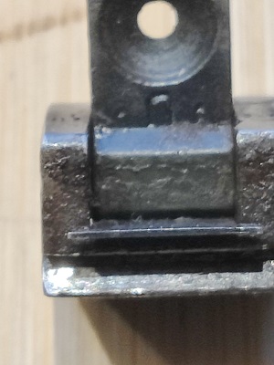

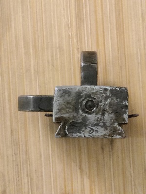

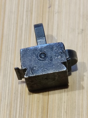

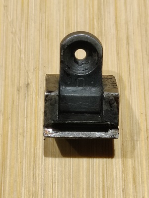

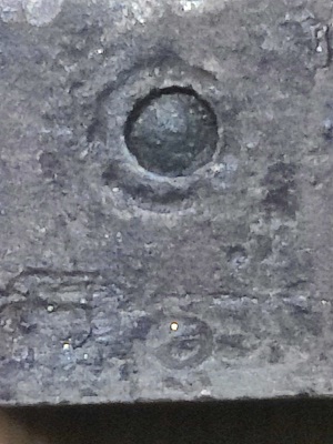

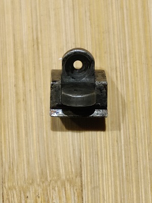

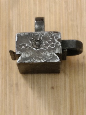

I bought this flip sight last week and it arrived this afternoon. It has some Cosmoline grease on it that is very hard. In the photos, it looks like rust. Leaf is stamped U and on the left side, an S is very faintly visible. It was once removed with a punch, causing some damage to the right side. Does anyone have any tips on how to remove the hard Cosmoline without causing further damage?
Regards Rico

Old hard cosmoline can be very difficult to remove. I'm hoping someone else will chime in with a better, less risky solution, but I've found that acetone is the best. It's available in hardware stores (In England, hardware stores are called Iron Mongers, which I find humorous. I have no idea what they are called in The Netherlands.)
The fumes of acetone are toxic (so use it outdoors or in a well-ventilated area), and acetone will eat rubber gloves and the hair on the back of your fingers! It will also eat the plastic bristles on the old toothbrush that you use to scrub the rear sight, so have a couple extra toothbrushes available.
But with all that said, acetone will also eat the old hard cosmoline without damaging the parkerizing. The sight will be left bone-dry gray, so apply some oil afterwards to restore the normal color to the sight.
Enjoy! :-)
Regards, mb
Marty Black
Post Options Post Options   Thanks (0) Thanks(0)   Quote New2brass Quote  Post ReplyReply Direct Link To This Post Posted: Nov 29 2025 at 4:01pm
As a general cautionary statement, acetone is flammable.
Nail polish remover contains acetone. So you may hove some on hand from the wife/girlfriend.
If you heat the part the cosmoline will soften to the point you can wipe it down. Not too hot, just as much as you can still handle it.

I’m with Dan on the heat. I use a little mini torch. Since I’ve started that, I’ve not used any chemicals at all. Good luck!

Thanks for the tips. We have a 4-oven AGA Cooker, each oven of which has a different temperature. I'll put it in the 100 degrees Celsius oven tomorrow for 10 minutes. Let's see if I can get it clean then.

not do sure I would do it in my kitchen stove. There will be fumes.
Also start at 50 - 55 c
You want to warm it, not cook it.
You could also boil water. Pull off heat and add a few drops of dish soap. Then soak the part. But then you would have to remove all water, and then oil part so it does not flash rust
Post Options Post Options   Thanks (0) Thanks(0)   Quote Superdort Quote  Post ReplyReply Direct Link To This Post Posted: Nov 30 2025 at 2:24pm
The fumes won't be a problem. This is an English cast iron Aga Range Cooker that vents its fumes outside through an exhaust pipe. The flip sight has been in there for about an hour. After that, I was able to rub most of it off. Now it's sitting in Coca Cola to remove the little bit of surface rust on it. It may sound silly, but I've had the best experience with that for removing surface rust.

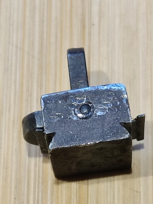

Post Options Post Options   Thanks (0) Thanks(0)   Quote Superdort Quote  Post ReplyReply Direct Link To This Post Posted: Dec 02 2025 at 2:37pm
Hi Dan,
Yes, most of the old cosmoline has been removed. There is still some left in the damaged areas, but that doesn't bother me. The leaf still looks good, only the base is missing its parkerizing. But that was to be expected. The S is now clearly visible. I'm going to oil it some more over the weekend. I'm very busy with work at the moment. Now you can also see how much it has been damaged by time.
Regards Rico
Post Options Post Options   Thanks (0) Thanks(0)   Quote New2brass Quote  Post ReplyReply Direct Link To This Post Posted: Dec 02 2025 at 4:28pm
Rico, thanks for the update. Someone sure banged up that base.
