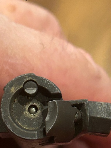

Post Options Post Options   Thanks (0) Thanks(0)   Quote abody711 Quote  Post ReplyReply Direct Link To This Post Posted: Dec 17 2025 at 11:13pm
Pictures

Post Options Post Options   Thanks (0) Thanks(0)   Quote Jond41403 Quote  Post ReplyReply Direct Link To This Post Posted: Dec 18 2025 at 2:41am
I'm no expert but the bolt ramp looks fine to me. It doesn't look worn or filed
Post Options Post Options   Thanks (0) Thanks(0)   Quote floydthecat Quote  Post ReplyReply Direct Link To This Post Posted: Dec 18 2025 at 7:25am
How is that bolt marked?
Do I see .u. under the left lug? It looks little fired to me and maybe because it never worked. It seems you have chased your problem to that bolt and the fix is to replace it.

Post Options Post Options   Thanks (0) Thanks(0)   Quote abody711 Quote  Post ReplyReply Direct Link To This Post Posted: Dec 18 2025 at 8:47am
Yes it has .U. on  the bolt. What is the meaning of .U.?

Post Options Post Options   Thanks (0) Thanks(0)   Quote floydthecat Quote  Post ReplyReply Direct Link To This Post Posted: Dec 18 2025 at 8:59am
Manufactured by Underwood, a genuine USGI bolt. It’s difficult to say what might be wrong with it. Various surfaces have to be in the right place. I have ran across an Inland bolt that had to be polished in a couple of areas to make it run. I think it’s very rare to have a problem with a USGI bolt but anything is possible.
Seems to me that you have determined that bolt won’t run in two different carbines. You could send it to me and I can look at it and test it in my carbines. If it will run for me, I could swap you another bolt. If it won’t run for me, we will know it is definitely faulty. Otherwise, I suppose you need to obtain another bolt.

Post Options Post Options   Thanks (0) Thanks(0)   Quote floydthecat Quote  Post ReplyReply Direct Link To This Post Posted: Dec 18 2025 at 2:27pm
Can you get a better picture of this? This picture is too fuzzy to zoom it and get a closer look inside the triangle.
