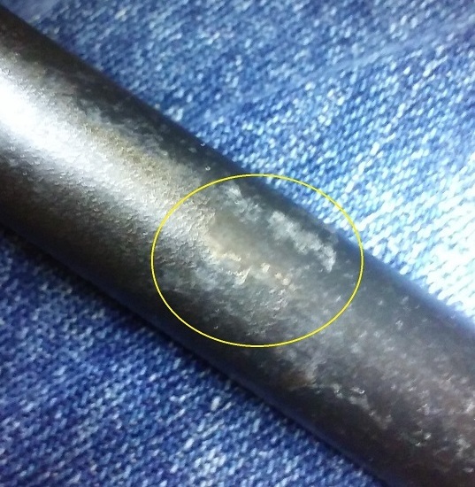

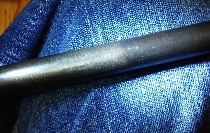

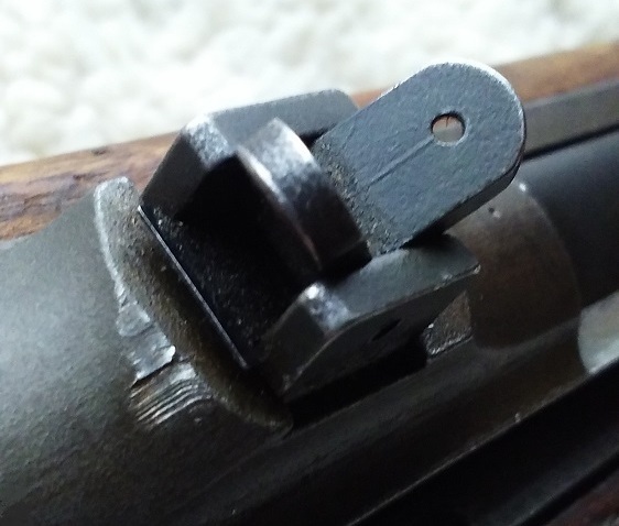

Here's an example of what to look out for on Carbines. Here's one I received and was an apparent put together when held in hand. There are 2 indicators of a rebuild in this pic. One is the dove tail where a type III sight once was installed/removed. You'll have to guess at the other, though it's not much of a mystery.
Post Options Post Options   Thanks (1) Thanks(1)   Quote tenOCEE Quote  Post ReplyReply Direct Link To This Post Posted: Jan 28 2018 at 11:23am
Bayonet shadow markings; here are other indicators to look out for on them. Held in hand, nobody can mistake what we have here. Band shadow from Hades. Confused In pic 2, note the circled area that doesn't photo well shows the pad wear from the type III barrel band. There will usually be at least one more mark from the 3 pads on a bayo lug. Someone chemically treated it to hide the shiny spot of the pad wear.

Must have used a hammer to get the adjustable sight off.

Post Options Post Options   Thanks (0) Thanks(0)   Quote 1st M1 88 Quote  Post ReplyReply Direct Link To This Post Posted: Jan 28 2018 at 12:33pm
Looks like rear sight leaf has a casting line running down the center.
Post Options Post Options   Thanks (0) Thanks(0)   Quote tenOCEE Quote  Post ReplyReply Direct Link To This Post Posted: Jan 28 2018 at 12:59pm
Yeah, it does. And as we know originals were not cast.
Or a crow bar. I've seen them with smaller divot contact marks from a stamped type III but wow...
Post Options Post Options   Thanks (0) Thanks(0)   Quote m1a1fan Quote  Post ReplyReply Direct Link To This Post Posted: Jan 28 2018 at 1:04pm
Looks like a repop flip.
Attempting to remove or install a rear sight the wrong way usually ends up with some kind of blunt instrument involvement. Subtle signs are also usually left behind even if the replacement sight is USGI.
