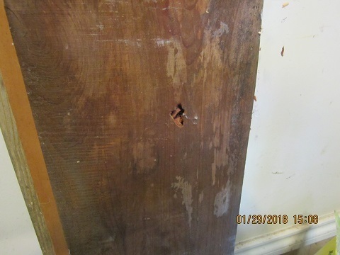

Now, all set up, I fired the first round. Seemed to work fine. I looked at the boards at the end of the tube and did not see any holes. So far, so good. I fired the second round and checked the boards again and....uh, oh! There is a hole.
I had missed the hole from the first firing due to a shadow on the board.
Checking further, I noticed 2 holes thru the sheetrock of my garage wall. Fortunately, no penetration thru the brick exterior wall.
Had to beef it up some. So I placed a 3 inch thick landscape timber between the end of the tube and the boards. Now, she's good to go.
"BAM BAM". Couldn't believe my eyes!
And the BACKSIDE?
They did not penetrate all the boards however. But before continuing, I filled a bag with 6 inches of sand, and sandwiched it between several of the folded blanket 'wads' in the tube. That finally did the trick.

M1A1FAN Photos not future. I reassembled everything in order after test for the story. Thought the CC might be interested in the process/result.
Post Options Post Options   Thanks (0) Thanks(0)   Quote m1a1fan Quote  Post ReplyReply Direct Link To This Post Posted: Apr 02 2017 at 2:49pm
Colreed, great details, appreciate you sharing them. I was making reference to the date time stamp of your pictures of 2018. Just kidding of course, no offense intended.

GOOD HEAVENS!!!! Never saw the pic date. So much for detail. Thanks. Absolutely no offense taken. Not even close. Hope I didn't infer.
