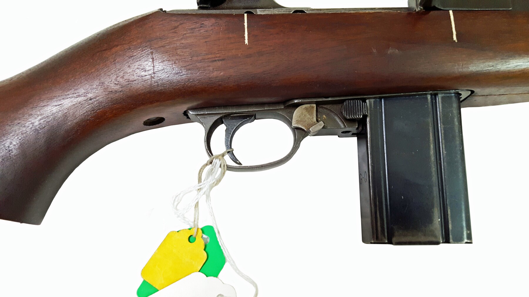

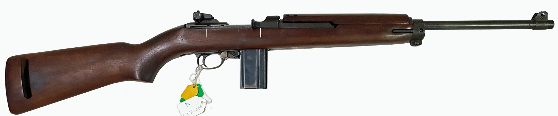

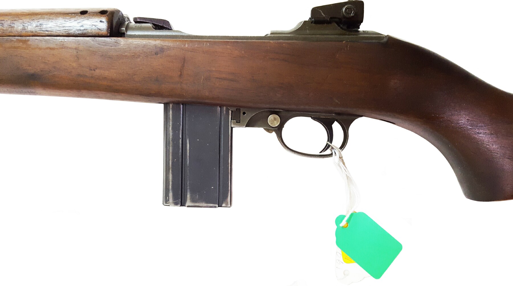

The carbine depicted in this post is a Winchester prototype. It is part of the Winchester collection at the Cody Firearms Museum in Cody, WY. The collection was donated to the museum when the Winchester Museum was closed pending the sale of the company in the 1980's.
We were asked by the folks at Cody if we could help identify the history of this carbine as no information came with the carbine.
A little background about prototypes may help some understand the mix of parts on this particular one. Prototypes were test guns for various research and development projects. They were often used for more than one project over time. This one appears to have been used for at least 3 or 4 different projects. Possibly with several being tried together.

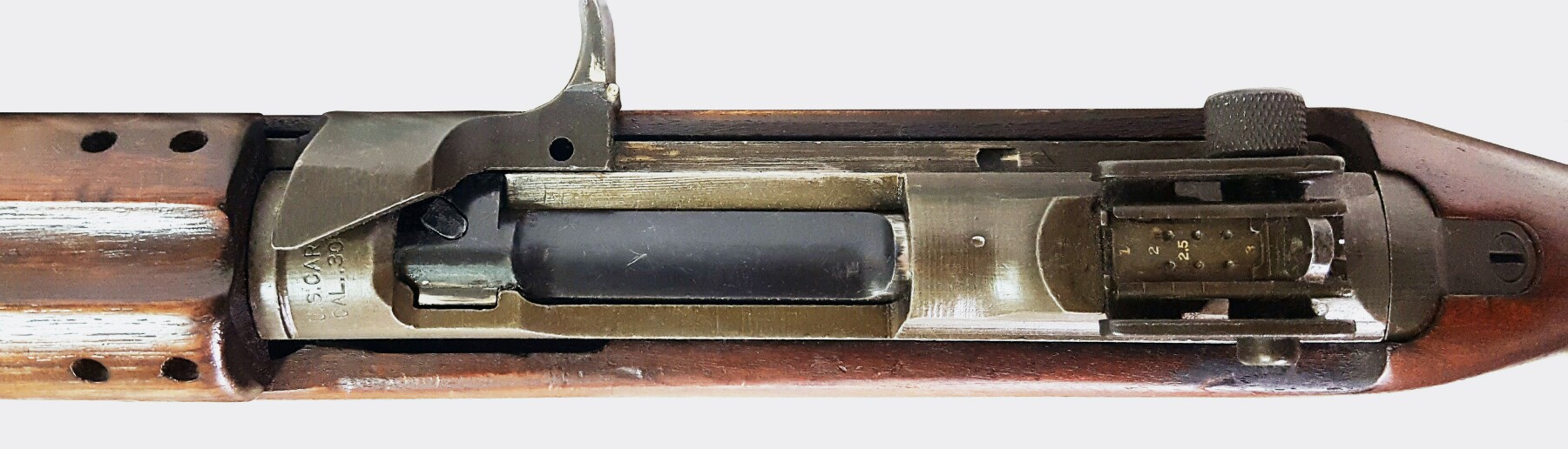

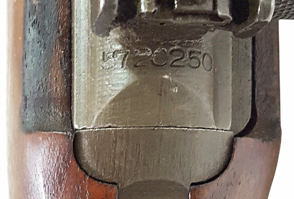

The serial number is 5720250. It has an undated Winchester barrel with Winchester's proof mark. The stock has an oval sling cut with low wood in the slide area. The carbine was not disassembled given it's a museum piece and to avoid any difficulties that may have been encountered trying to reassemble it due to the prototype parts.
It's been suggested the holes in the buttstock may have been part of the tests with the combination tool set shown above. Those tests were conducted by Ordnance and the Infantry Board post WWII using M2 stocks. This one has an M1 stock but it's possible not all stocks tested were included in the report. Since this was part of the Winchester Museum it was retained by someone on a level with Olin and/or Pugsley for inclusion in their collection. At what point it was added to their collection is not known.
Another possibility for the holes in the stock was the testing done to develop a stock that wouldn't crack when launching grenades. According to Larry Ruth in War Baby, Volume II, pages 541-548, Ordnance began a series of tests for this purpose starting in August 1948. Production of the first grenade launchers for the .30 cal. carbines began in October 1943 with a revision in the latter part of 1944 continuing production until V-J Day in August 1945. With total production being 387,165 grenade launchers. Obviously the issues with stocks cracking was well known before the Ordnance trials post WWII,
Parts on this carbine include known prototype parts in the development of the select fire mechanism for what would become the Model M2 carbine. Research and Development for the mechanism best suited for select fire began in May 1944 with Inland and Winchester producing prototypes (refer War Baby, Volume I chapter 16). The Inland design was adopted and first used with the Inland Model T4 carbines (marked T4 on the receiver instead of M1) by July 1944, the prototypes used in the development of the M2 carbine. But Winchester research into a different select fire mechanism continued.
Winchester's device was named the No. 3 Mechanism. Winchester carbine s/n 5720250 (the carbine depicted below) with parts that "embodied the principal" was viewed by Ordnance at Aberdeen on November 21, 1944. With the carbine test fired to show it worked (War Baby, Volume I, pages 247 and 248). The design of the parts underwent changes and were assembled into four later Winchester carbines submitted for trials June 1-8, 1945 at Aberdeen. The trials concluded the Winchester design compared favorably with the Inland design but was submitted too late. The Model M2 carbine with Inland's select fire mechanism, designated "Kit, M17" , had already been adopted by Ordnance October 26, 1944.
Another experiment this carbine shows evidence of is the research and development that produced a revision of the carbine slide incorporated with carbines beginning November 18, 1943 (part #D7160091,shown as slide #V on the web page for the slides.) The design included a number of changes that included increasing the dwell time to eliminate breech flash and reduce strain on the recoil mechanism. Look closely at the slide handle. The marks on the right side of the carbine were related to measuring slide travel. Also note the flattened nose of the stock and the barrel band.
Back to the holes in the stock. No evidence has been found so far as to what these were for. Possibly the cleaning kit. Possibly a buffer mechanism for use with the grenade launchers. We hope that at some point to be able to examine photographs showing the carbine with the stock and handguard removed since these photos do not show enough of the design to reach any conclusions.
