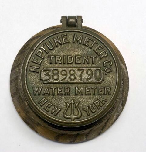

Here is one for you minutia guys to go with the link above
Neptune Meter made water meters. They also had their own foundries to cast the covers and meter bodies
http://www.uscarbinecal30.com/forum/uploads/3657/tri2.jpeg
