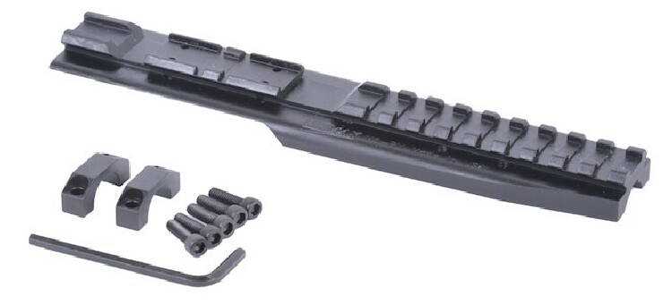

Ultimak
       https://ultimak.com/product-category/m1carbine-category/
The Ultimak kit (came with an extra bolt)
Installed - I didn't care for how far forward the barrel clamps were with no rear support.
The biggest objection I had/have to the Ultimak is my stock has a long barrel channel, installation of the Ultimak requires removing several inches of the barrel channel so the Ultimak will fit. No thank you.
When installed properly it doesn't sit on top of the wood and stays secure.
