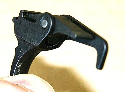

just bought my first carbine and completely broke it down to get all of the old grease and junk off and get it looking and functioning nice. Everything went back together no problem  when I go to rack it the hammer won’t stay cocked.  If it take it out of the stock and pull back real hard I can the hammer to stay back 30% of the time but never while in the stock.  Did I do something wrong reassembling? Is it the springs.  I have a video for reference

check you have the trigger spring in correctly, it looks like the triggers is not reset.
if not take out the trigger sear and sear spring. Assemble out of the housing. Check the sear function. the sear should push back as well as pivot

I think Dan's right. Tip on easy assembly, cut a Q-tip the width of the trigger, that allows you to assemble the trigger, sear spring, and sear outside of the housing. Then just push the Q-tip out with the trigger pin. Insert the trigger spring at 90 degrees and over the shelf at the top rear of the trigger, rotate 90 degrees into place.

Here is JimF's pics and tutorial on how to make a pin to put the sear, sear spring and trigger together outside the housing.
I made my pin from a cut down finish nail.
"Trigger and sear/spring. Make a small pin the width of the trigger. Assemble the trigger sear and spring outside the housing using the shorter pin. Drop it in the housing, line up the hole and push the normal pin into place. Done deal, a minute or two and no jammed fingers."

Is it because the spring coil is bent ?

Probably,
You could try bending it back in place, install and see it hammer cocks.
But order a new one.

Looks like one leg of the spring is broken.

yeah I took it apart 4 times.  Is it worth ordering a new sear too?

Sears are pretty durable. Unless you see some physical damage or wear probably not. You can post some pictures for opinions.

took everything apart again the seat is definitely not worn at least from what I see.  I ordered a new trigger spring and hammer spring but didn’t get a new sear spring yet.  Seems really strange, I am by no means an expert but would never guess the trigger spring would create this problem

Without the second arm, it doesn't have the strength to reset the trigger. That is where the problem is.
